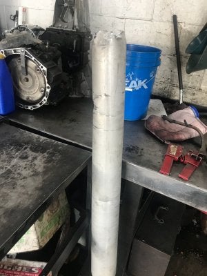

From time to time I would like to show you guy’s some of the interesting things that I encounter in my line of work. In this example you’ll see what happens to an alumium driveshaft when the front u-joint fails.
If you notice a vibration that kinda goes away when you let off the gas, but comes right back when you give it gas, its usually driveline related. The same can be true for fwd CV axles or halfshafts as they are sometimes called.
So if you notice a chirpping noise at take off and parking lot speeds , or the above mentioned vibration, get it checked by a competant mechanic.
In case your curious, theres a four foot foam plug that goes inside this one for noise control. Im keeping that. Just the right density for mounting pickup’s. Ha
View attachment 107816View attachment 107817View attachment 107818
