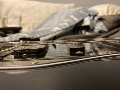

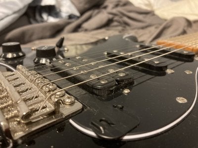

Can you show photos please? If we see how the tuners are strung up, your pickup heights, your bridge saddle positions, we could help diagnose what needs to change....

THIS is why you're having problems, the guitar has never had a professional full setup - you also have your tuners wrapped the wrong way, the saddles are NOT intonated, the pickups are too high. You should find a good guitar tech and pay to have a pro setup done.
EDIT - if somebody already looked at this, they are NOT incredible, they are terrible at guitar setups....
Going flat all the time is due to the tuners being strung the wrong way, improper forces at the nut, the strings not being fully stretched, the setup not being done, and the bridge float or decking not being properly done.
