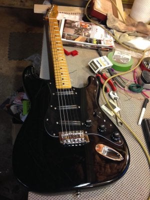

You can really put about any neck or body to the other just as long ax the scale length is correct. You may have to do some minor modifications. I have done a few,
