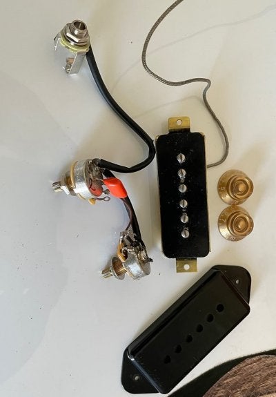

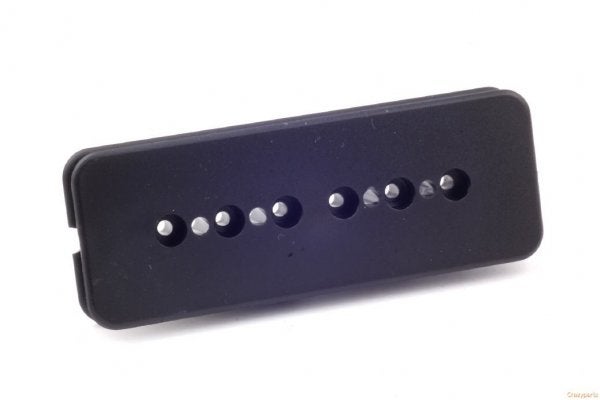

Thanks Spin . With the original Gibson LPJ having P-90, that was a consideration. I've read that drop in P-90 are not all they're meant to be. Can anybody comment to that or suggest one that is maybe? The dogear would mean the irreversible mod, not that it would matter if it's a big improvement. You can always use a pedal for distortion.
Humbucker sized P-90s
That's +1 for the P90.
Genuine Gibson P-90 with controls (2019) LP Junior. Not a bad price and would still be a very cheap guitar.

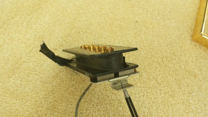

Yrs back, I did a post on the conversion of a humbucker to a dogear P90. Hopefully you can find it. It shows the entire process, pics, wiring, and the modified rout. It's the only way to go with a Jr and you will never want to reverse it. And, you don't have to spring for a Gibson pickup, a standard "dog" with 500 pots will get the job done.

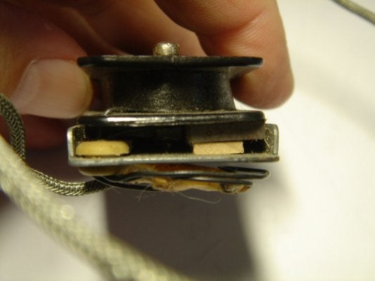

I finally got a slight start on the Maestro LP Jr conversion from HB to dogear P90 pickup. Not much time in yet, but I figured starting the forum would make me geddy-up. $50 Maestro in near new condition, fret edges were the best I've seen so far, but still not good. So frets & edges got the sanding block treatment 220 to 600 until smooooth. Tuners removed, I have a set of used Grovers ready to go. Nut popped out with a swipe of an exacto knife and was replaced with a pre slotted 43mm bone nut from GuitarMadness, which was an easy drop in. Rosewood was darkened with black stain.
Out with the HB (free to a good home should someone need it). I got a pair of P90 dogs (one for another project) also from GM, $22 shipped, 8 & 9K w/ferrite mags, along with a pr of 500 pots, $6. Seems each dogear has a bit different construction and depth, which determines the dictates the modification of the HB rout. The trick is to center the dogear in the HB opening which should eliminate the potential of a space in the top or bottom of the opening. You can see the outline of the proposed cut sketched on the masking tape over the rout. The P90 cover is also sketched to be sure the modified rout cut will be hidden. Making the cut will be part 2, I'll take pics and will be cutting right thru the tape. View attachment 134897 View attachment 134898
@ sausagefingers Ok, here's a post on one conversion. I also did a few more, but this shows the rout mod, which can easily be done with a Dremel saw with a small blade. It's merely a drop cut to create a "shelf" to accommodate the height of the pickup being installed. As you can see, the HB rout (top to bottom) is not affected, only the ends. The dog ear cover just about hides the old rout, with maybe a "pencil line" visible.
Any questions, fire away.

IMO the Dream 90 sounds good, but doesn't sound anything like a P-90. IIRC it has a Strat-sized coil and that's why 250 K is recommended. The Mean 90 has a larger coil form and is closer to a P-90 tone.
