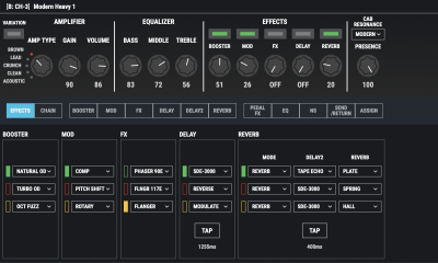

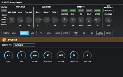

    Here are my settings atm - I’ve got two metal tones, one slightly more thrashy (Modern Heavy 1) and the other deeper (Modern Heavy 2) which ill post below.
    I play these settings on the .5watts mode, through a 1x12 Marshall Cab loaded with its stock Celestion 12B-150.
    My Master is usually between 2-4, and it’s been tailored to my EMG-81 loaded guitar, though I just tried out my SD loaded Ibanez (which I’ve recently finished setting up) and it still sounds pretty good through the HBs.
    C0A8945A-1566-48CE-8486-C28665B07B04.png CE05B15D-DD5F-4900-879F-8CC10AC5627F.png
    915C46D3-B320-4BB5-99D4-C4CA35F28058.png 4CED62DC-2C6C-4283-AA0B-1AF88567FF47.png 27F98236-CE8D-4999-AED5-FC210615B111.png
    Eddie and beagle like this.

    Oh I forgot to say, I don’t have any feedback issues, and the Noise Gate doesn’t clamp on the sustain at all. There’s a slight hiss, which I imagine playing louder will amplify, but it’s relative to how loud you play! The hiss is probably about 10% of the level of my guitar tone. You’re never gonna have a high gain rig without some hiss.
