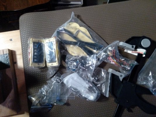

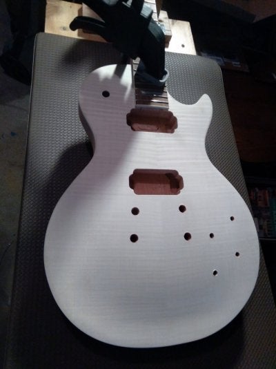

I have seen these for years and finally got one. This will be interesting and a miracle if it turns out at least a little like i hope. First thing put the black light on it and hope glue squeeze shows up and hopefully remove it. It actually looks better than i thought it would. Electronics like pots and switch will not be used i can't handle small pots i have a hard enough time seeing to solder full size ones. A lot depends on neck fit and bridge fit turns out. 20221005_191511 (1).jpg 20221005_191420 (1).jpg 20221005_191913 (1).jpg

If the veneer isn't up to a stain or dye, gold top it. People have trouble with glue squeeze getting all over the top and they end up sanding through the veneer trying to fix it. Be careful sanding! Using a black light to see the glue is something I never thought of.
I put the blacklight on it last night and marked glue spots on the top. I have watched so many youtube videos where someone just goes at it with no prep and it ain't pretty. I figure 2 light sandings is it on these thin veneer tops.

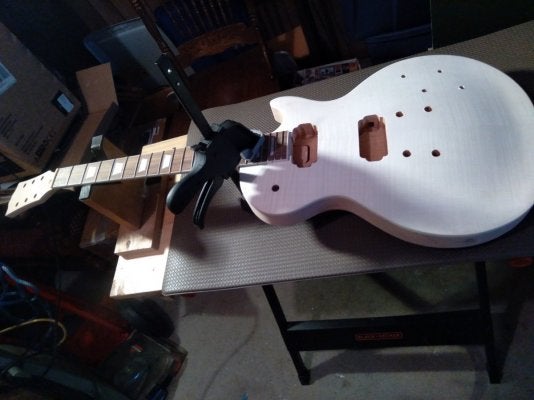

I got my dye powders from Amazon today alcohol base so hopefully very little grain raise. Since no videos on this brand and little to go on but reviews on Amzn i ordered some maple veneer yesterday for some testing before attempting to have a go at dying top. I put the bushings in the body for bridge and tailpiece. I will put 2 tuners in the neck and dry fit with 2 sided tape 2 check neck angle and bridge alignment next. 20221006_202106.jpg

I hammered in the post bushings screwed in 2 tuning keys to see how the bridge placement and neck angle looked. Nut appears cut to low right off hand but until its strung up hard to say for sure. The bridge and tailpiece had a name stamp on bottom but someone used a Dremel to scratch some lettering off but you can still read Epiphone on it.
