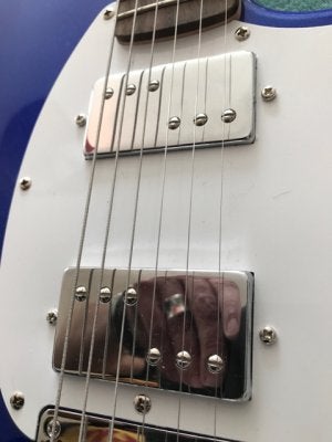

3. I switched the pickups for wide range type humbuckers with a little less bite but a lot more expression and voice. I had to carefully rework the pickguard to make them fit. They can be split as well - I think I will add push/pull pots to explore the possibilities...
Humbuckers are F&M and from an eBay seller named Thor-guitars.
