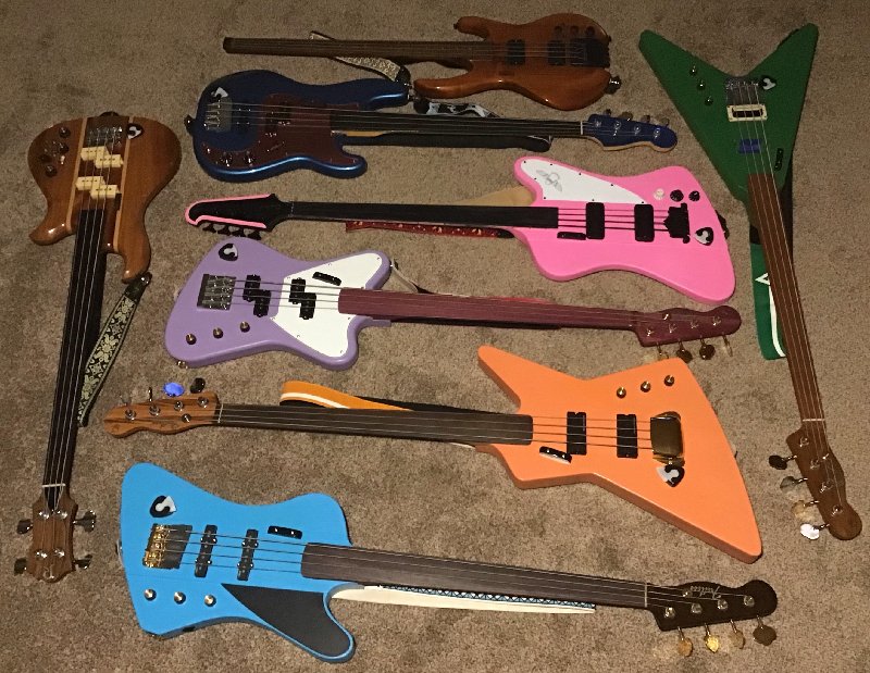

  13. AngelDeVille
    AngelDeVille Squier-holic
    109
    Jan 29, 2017
    ABQ
    The pink and the headless are conversions.
    [​IMG]
    L
    eft is a bubinga board with maple slots.
    [​IMG]
    Number 6, Big tuna and SoundDesign like this.

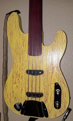

  15. AngelDeVille
    109
    Jan 29, 2017
    ABQ
    the koa is a 1980, the white one is a 1985, and was built for Don Lace...
    and some other fretless stuff.. 18D34C97-0139-486F-8AE6-442C516A47BF.jpeg 5532390B-4744-45E4-B3B4-A3ED43B1FFD8.jpeg 9CD84B0F-C8CC-47DE-9F28-235E909B81B8.jpeg 922ED089-7FB7-4B82-BA83-21448A1274FB.jpeg 7A14BAF7-F432-40CF-A3F5-92B355C13532.jpeg
