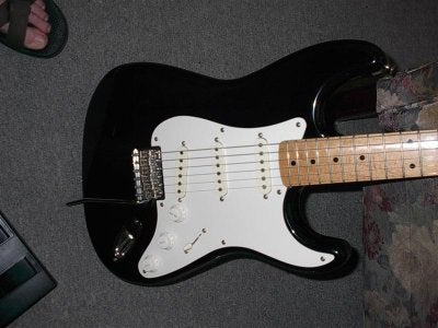

    Next came the E serial number Squiers
    the E serial number guitars start to overlay the A, B and C serial number guitars when they are produced.
    E + 6 digits 1984-1987
    A + 6 digits 1985-1986
    B + 6 digits 1985-1986
    C + 6 digits 1985-1986
    The E series are 50-60s based guitars similar to the JV and SQ guitars, but without vintage style tuners. they have fender japan stamped gotoh style tuners, and fender stamped saddles. Vintage style truss rod adjustment, and flat pole pickups. The serial number moves from the neck plate to the headstock, just under the squier logo.
    I will leave some time here for anyone with an E serial squier to post some pictures and continue with the A serial tomorrow.

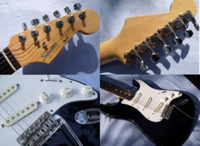

  3. rockape
    rockape Squier-holic
    Messages:
    1,078
    Joined:
    Dec 14, 2009
    Location:

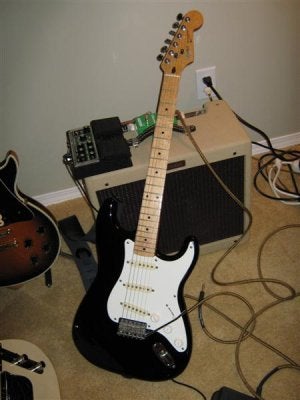

    Here's my own first issue export Strat, with a set of factory fit X-1's (JV02122 - neck date May 19th 1982).
    The sunburst on this guitar (and others from this period) is very a very attractive 'brown', which is identicle in tone to that of the 1979 / 80 Fullerton brown-burst Strats (different to that of my late 1981 (pre-JV) Greco Strat)......same paint perhaps???
    [​IMG]
    [​IMG]

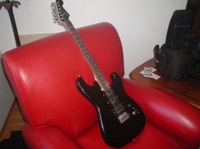

    Some E seriers also had guitars that had no pickguards, no-traditional switches, and no-tradition pickup configurations. In My Opinion, The E, A, B, and C serial guitars were made at the same time with the same specs for each different model, in 1986 the A, B, and C serials were stopped and the E serial was continued.
    from what I have seen, alot of the A, B, and C serials looks similar to alot of the E serial guitars.

  10. houseguitarshop
    houseguitarshop Squier-holic
    Messages:
    2,816
    Joined:
    Apr 1, 2010
    A series guitar
    this guitar looks similar to the E guitar in the previous post, but this is an A serial with the serial number on the bolt plate instead of the headstock

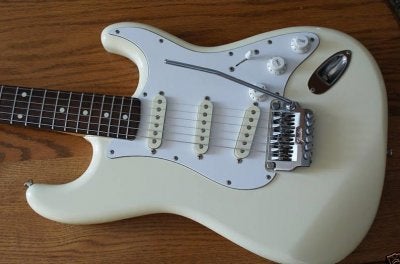

  12. houseguitarshop
    Messages:
    2,816
    Joined:
    Apr 1, 2010
    they also made E serial guitars with locking trem bridges and locking nuts, and E serial guitars with vintage trem bridges

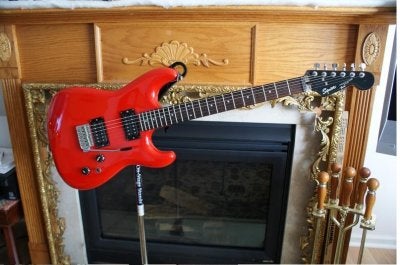

  17. houseguitarshop
    Messages:
    2,816
    Joined:
    Apr 1, 2010
    the other models
    now,
    I have not coverd this much yet,

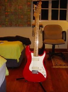

    there were JV serial bullet guitars, SQ serial bullet guitars, and JV and SQ bullet basses that were made in japan the same time as the JV and SQ Stratocaster guitars.
    these guitars, got all the water down hardware and electronics from the get go. alot also did not have as many body contours. these guitars had tele style necks and small strat shaped bodies, the bridges vary in style
    there was also a bullet with a strat style neck and a tele style body with an elongated bottom horn.

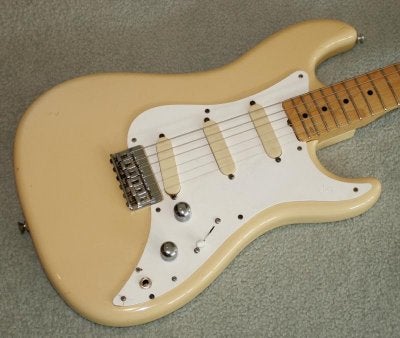

  18. houseguitarshop
    Messages:
    2,816
    Joined:
    Apr 1, 2010
    E serial Korean guitars
    I will leave a few days for anyone who would like to post a, JV, SQ, E serial, A, B, or C serial, or bullet guitars from Japan before I move on to Korean, USA, and Mexican Squiers

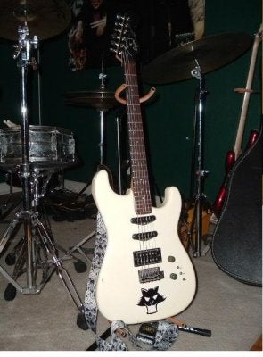

  19. Squier Buyer
    Squier Buyer Squier Talker
    Messages:
    17
    Joined:
    Dec 18, 2009
    Location:
    Vancouver BC

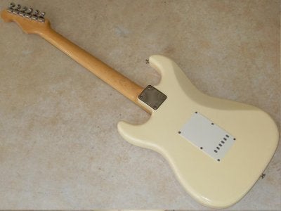

    E10xxxxx, yes, E1 plus 6 numbers. Fender stamped saddles, Japanese Gotoh "Fender" written on tuners. (non vintage). Two Japanese "Standard Model" big block black roller string trees, and ST-57 in neck pocket, note the 8 hole guard. Flat poll pups. Dime pots and plastic covered wiring. Full size solid body.
    Quote: houseguitarshop:
    " there is a theory that the parts were shipped to Korea for assembly only, due to the high quality of craftsmanship, authentic fender parts, full size bodies, full size trem blocks, etc. it is a little a mystery.
    I read in a book that it is inside known to fender emploies that the E serial korean guitars are some of the best made stratocasters out there."
    Thanks for all your research houseguitarshop!, fascinating, but I'm afraid I'm only going to add to the confusion.lol.
    The description above would normally make you think MIJ right? No it is MIK, at least that's what it says on the headstock! I too believe that my guitar has an American bridge with an early E10 Japanese neck and those distinct (ugly,lol) string trees which are clearly from a Japanese "Standard" model Strat as verified on numerous MIJ JV,SQ,E series websites. It has been explained to me by a collector in Montreal that the E10 necks were the very first ones made for the initial release of the first "Fender" MIJ Strats but were used as "extra" stock lying around on the Japanese E serial Squier models and later on the MIK E series models. He says I actually have a "Fender" MIJ neck and not a Squier MIK neck. The last clue is also fascinating. I cannot show in pictures because of the gold number on the maple headstock but with a magnifying glass I can clearly see that the decal has been altered in the area of the MIK part under the finish.....hmmmm......changed from MIJ????? One last thing. I bought this guitar from my best friend of 40 years and he swears he got it as a wedding present from his ex wife in 1984 and seriously folks it "sat under his bed" for 25 years! I've owned many MIA's, MIJ's and MIM's and this is the nicest Strat I have owned bar none.
