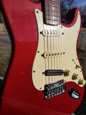

    I just now got through installing an import rail in my strat and did a before and after recording to see the difference and the rail by far sounds better to me and its driving my amp pretty darn hard. I mean I literally finished up 10 minutes ago lol.

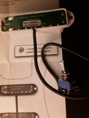

    They are decent but they do something with my amp i dont like . Try b4 buy them they sound diffrent on pc then amp 20190205_002540.jpg 20190205_003217.jpg
