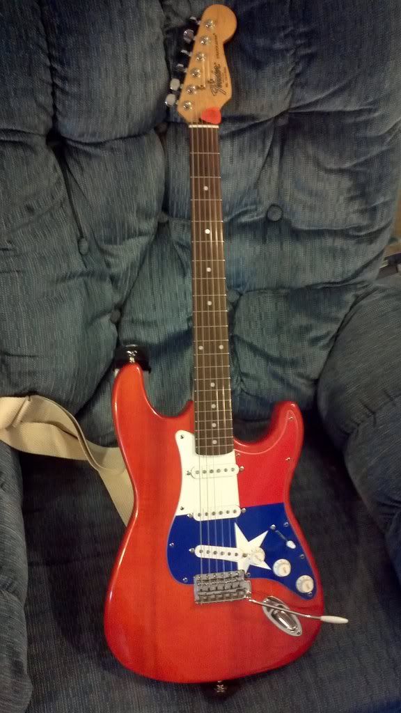

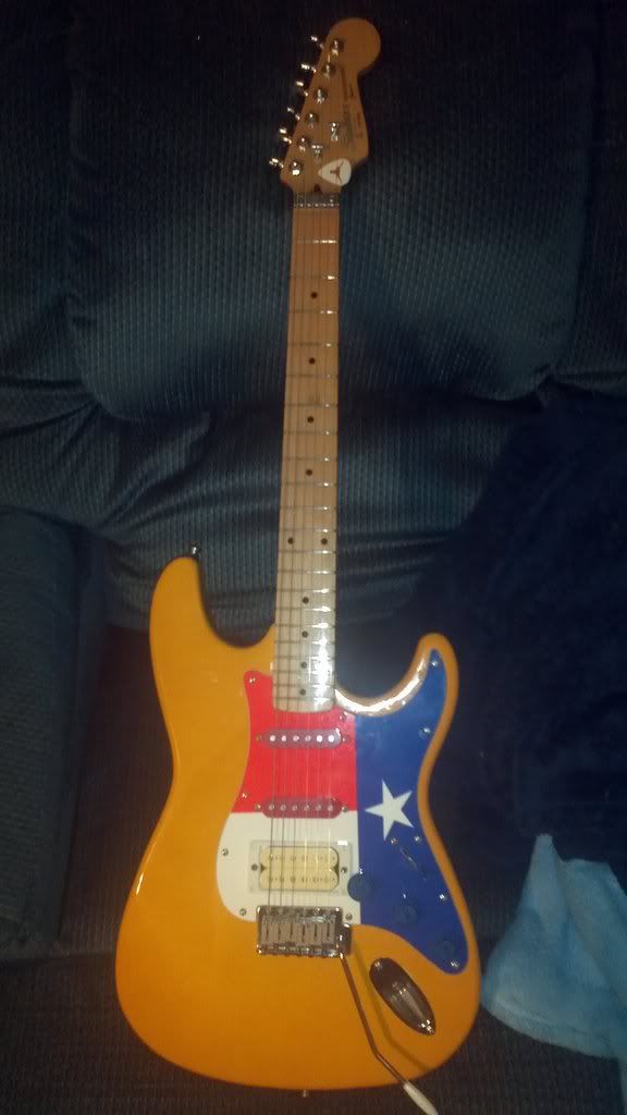

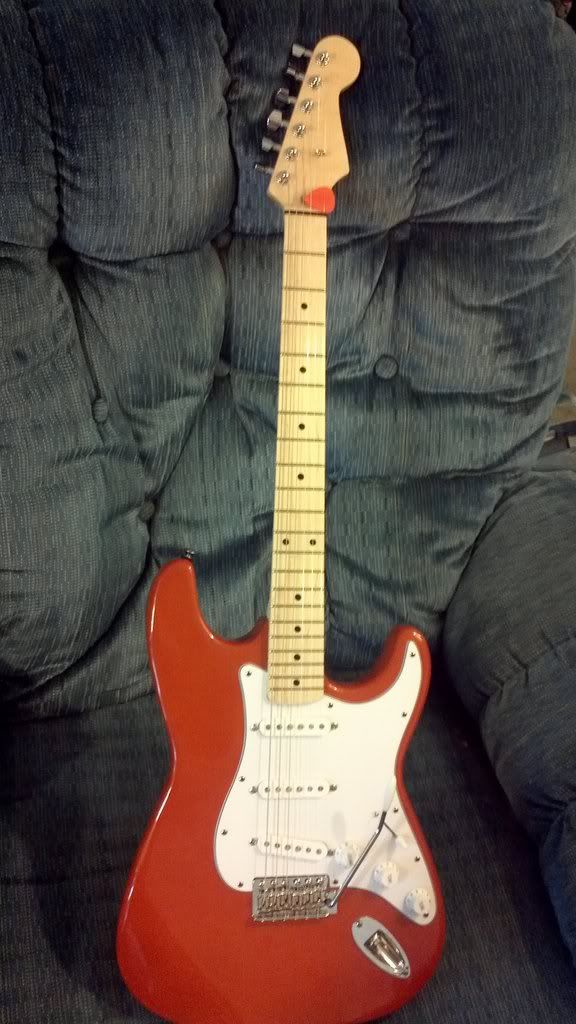

MIK E9 Squier II neck on Capri Orange Pawlonia body
MIK VN5 Squier neck on Cherryburst Pawlonia body
aftermarket neck on Deep Orange Pawlonia body
CN2 Fender Squier Series neck on Rockabilly Orange Poplar body
softwarejanitor is offline   Reply With Quote
